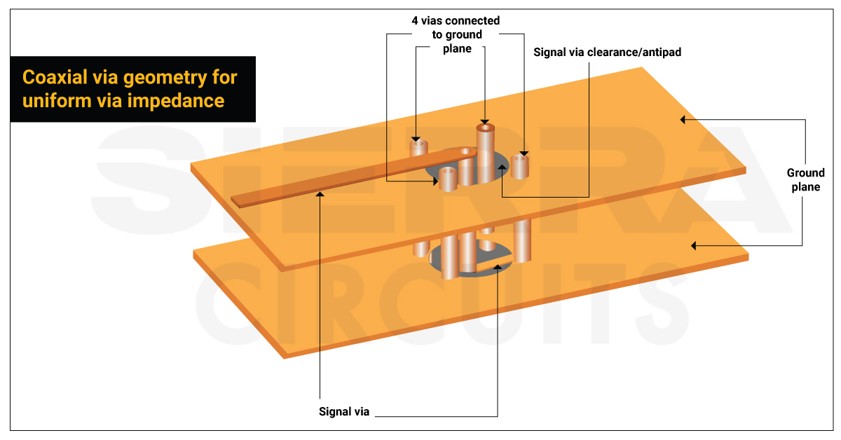

                  To achieve uniform via impedance, implement coaxial hole structures, and place ground via close to the signal via.
                  As DDR data transmission rates continue to increase, the signal integrity of the DDR channel has become one of the most critical concerns. This article takes an extensive look at the impact of via stubs on the impedance of the signal lines on DDR4 memory, including test cases and ways to optimize design.
